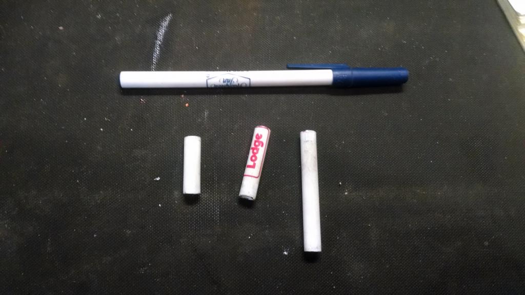

I took a simple bic pen not one that clicks just a simple straight pen and removed the outer tube and it worked for the purpose of alignment while bolting up the pressure plate.
I installed the bic pen tube over the alignment pins then the pressure plate went over the tubes and held the pressure plate perfect and true, I bolted up the pressure plate as instructions and then removed the tubes I made.
